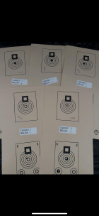

Yes, it’s sealed and was stored in controlled environment. I had a day to play with and it seemed to shoot ok, just need to mess with it some more. I shot these targets with 28.4gr/Barts ultras, the wind was tough and had me guessing.

This is what 27.5 did, it’s only 3 shot groups. I need to run it thru chrono to check the numbers.
