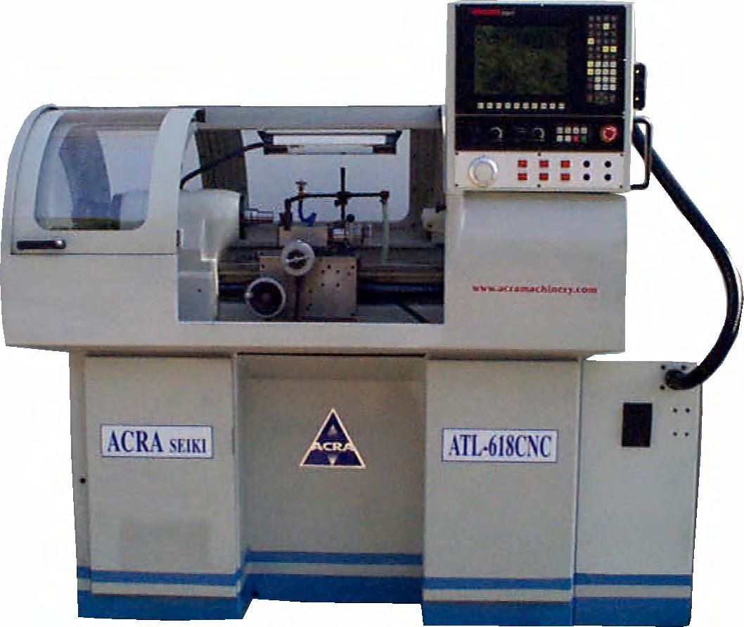

My Acra has vfd and electronic threading. All that it lacks is the bigger spindle and longer bed.

Which Acra is that?
Do you have a model number?
618 I believe it was/is. They make a CNC version now. I almost bought one (manual) but couldn't justify it at the time.
Here's one with electronic threading:
CNC version:
I have never seen one close up but from what I understand the head is too long or spindle too small for barrels?
The spindle bore is 1.5" I think, but I never measured mine. The headstock is long, but Jackie made bushings to slide in the spindle to allow him to do them in the headstock. He is using a different machine now. Distance between centers is 20" unless you have one of the rare 30" models.

For short barrels, I have a custom chuck/fixture I can use, or a barrel extension. Clamps onto the barrel and gives the length needed to reach the outboard spider.
Here's the fixture.
Man that is a really really sweet machine.
