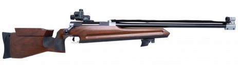

Grunig and Elmiger Supertarget 200
Hey there i purchased this rifle a while ago however it did not come with any instruction manual. I am particularly after information on how to pull the bolt apart.
If anyone knows of a manual describing bolt maintenance it would be appreciated

I’ve got a paper copy of the manual showing how to disassemble the bolt I can photograph if needed.
Basically just uncock the bolt then push the silver end cap towards the bolt face and turn anti clockwise then slowly release.
