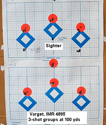

The thread starter, Tominboise, reveals this is a Savage, presumably with factory barrel: "This particular rifle I traded into and am playing with it to see how it can do. It is a Savage 110 243 Win, sitting in some sort of laminated target stock, full floated, blind magazine, sporter weight barrel."
If it's indeed a factory barrel, that may be the end of discussion. I had a Savage with factory .260 Rem barrel. Four plus a flyer (one flyer opening group to 0.7-0.9 inches at 100 yards) were almost constant with a few 3 and 2. Constant split groups.
I tried everything -- four different powders, 6 different bullets, different primers, turned necks, tried necking up .243 and necking down .308 Win Lapua, tried various seating depths. All to no avail. The gun just gave flyers.
Then I screwed off the factory barrel and screwed-on a prefit 6BR PacNor. Problem solved. The first measured group (rounds 16-19, 4 shots) made a ragged hole about 0.170" -- Witnessed. The gun never showed the tendency to toss flyers with the new barrel, and consistently shot in the twos. Here are NINE 3-Shot Groups at 100 yards with two different powders and various seating depths.
So these days, when I see problems like the OP describes, I always ask: "Is this a factory barrel?" That may be the whole problem.
If there were 10 Forum Boss Commandments, one would be "don't waste time and money on an erratic factory barrel".
Then I screwed off the factory barrel and screwed-on a prefit 6BR PacNor. Problem solved. The first measured group (rounds 15-19, 4 shots) made a ragged hole about 0.170" -- Witnessed. The gun never showed the tendency to toss flyers with the new barrel, and consistently shot in the twos. Here are NINE 3-Shot Groups at 100 yards with two different powders and various seating depths.
