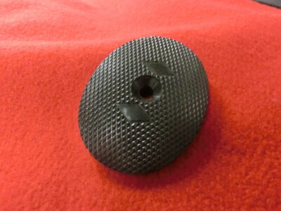

I'm pretty sure the one I posted will fit, Your ruler is offset a little bit in your pics, But I think the steel grip cap from NECG will fit.

According to the pics with a caliper, that horn grip cap will be small, leaving edges. I'd rather have one slightly too big, and work it down to size. There will likely be no "drop on" grip cap for that stock.

When fitting grip caps, the standard method is to start with a slightly oversized piece of material and work it down to an exact fit.
Material selection is most commonly the horn grip cap material on the older, classic stocks. These were then matched to the horn butt plate as well. I even have one older stock with a horn forend tip...
Most common though is the ebony grip cap. The drawback here is the quality of the ebony on the firearms market today. You will look far and wide for the classic deep black ebony as found on older stocks. There is a limit to what we can get now as far as quality is concerned.
Not the best but still a sample. Not yet finished:
