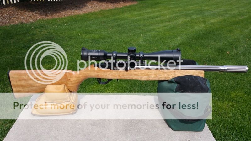

Having had Lilja, Shilen, Kidd, Feddersen, and now the Green Mountain 17.5'', I think I would have to give the nod to the GM on accuracy. Finally got this build completed and took it to the range today for accuracy testing. This set up is like a laser with SK match. :bthumb: :bthumb: :bthumb:
Ruger receiver with JWH custom bolt, Kidd trigger, Zeiss scope, GM barrel, custom cherry stock.
Really nice looking rifle!!!!! What is the deal with the barrel? It looks as if it has a fluted piece added to it from the picture?
Thanks gentleman for you kind words. I swapped out scopes and put a Bushnell 6500 4.5-30x50mm Mildot on it and took it to the range this afternoon. It really like the SK in a can. Very impressed with this rifle both looks and performance.
