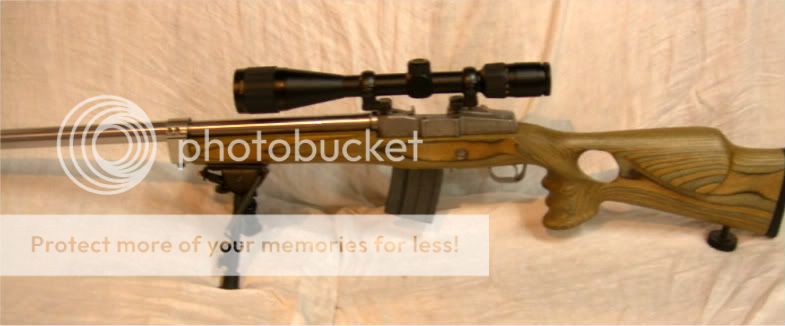

I have a Ruger Mini 30 that has had a ton of work done to it including a heavy stainless barrel in 6PPC
It is too heavy to use for coyotes but perfect for the way woodchucks are hunted in my area. Shots are rarely over 250 yards but woodchucks are dead right there
