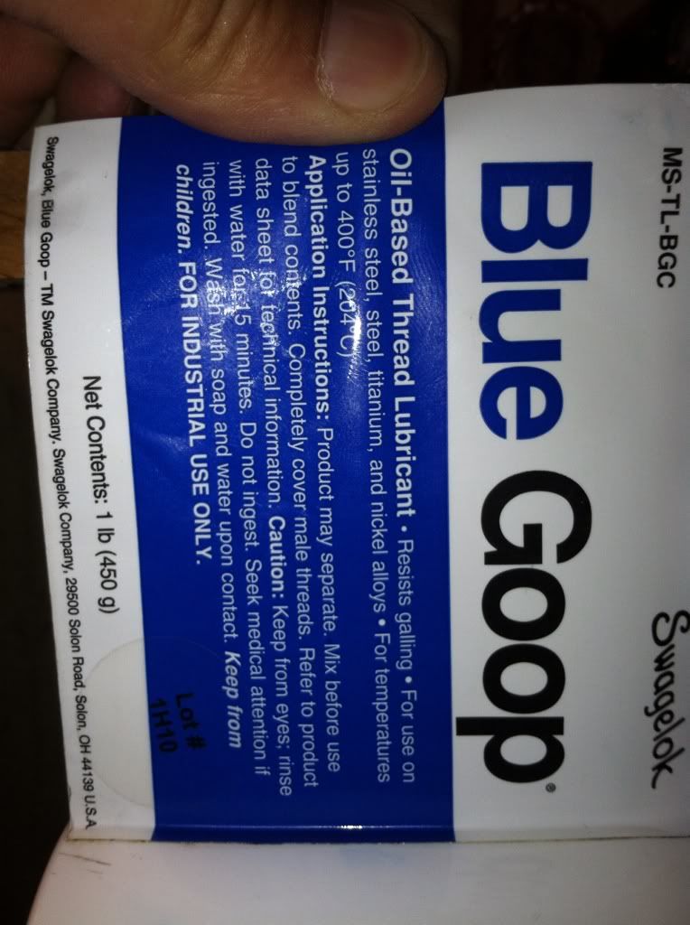

ProGold in the syringe is what I use too. I also share Reed's overall point of view on bolt maintenance. Previous to the ProGold I was using some specialized engine assembly lube that was dispensed with a glue syringe that came from a woodworking supplier, see bottom picture.
Since any good grease would do it seemed like a good antidote for cabin fever to explore other products and discriminate bolt greases with different criteria.
So far these are my findings:
Best smelling grease: see first picture
Best color grease: see second picture
Most comfortable grease: (note; not recommended for steel bolts)
