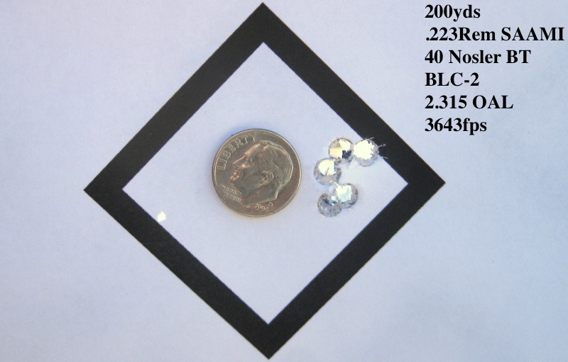

As soon as we jump up to Coyote land my CZ 527 in .223 will obviously do, but has a 1:9 twist so I can’t go too light in bullets.
What's wrong with a 1:9" and lighter bullets? I have a 1:8" CZ 527 in .223 and it does just fine with the lightweight stuff:
