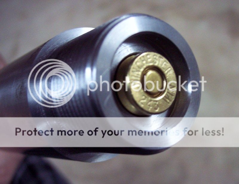

gonna try 243 Win
slightly worn Krieger 6BRDX bbl sittin around collecting dust so I sent it off and had tennon cut off and chambered in straight 243 and throated long enough to seat a 105 Scenar above donut area and have .050 jump,,just to see how it will do and what kind of speeds it will produce,,
in other words just for fun and the heck of it,,,gonna try and screw it on tomorrow and see if it will go bang,,
pic of the 105 Scenar loaded to 2.910 next to the BRDX with 105 VLD at 2.415,,
if nothing else I bet it will be fun to shoot steel plates with..
