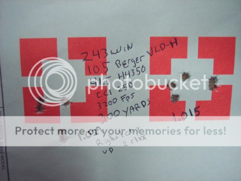

I gave up and went back to H4350 that has proven to me over the years that it will not cause me problems even if I am running on the edge of sanity,,
I will be putting this bbl/action in an AICS to be shot prone at steel plates,,I figure 1 inch groups at 300 yards at 3200 fps with the .532 BC 105 orange box Hunting VLD should be a killer load that will feed and function through the AI mags,,
should shoot like a 190 gr 300 Win Mag without all the recoil and cost,,
A near picture perfect call on elevation & windage. Very nice round group. You're doing everything right. Are you going to Melonite it?

mr.big what did you find out? what made you switch back to H4350 so soon with little testing?
