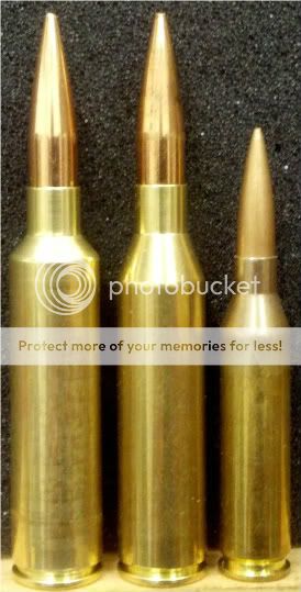

I know you said you went with a 338 but, this is what I came up with for a big 30 cal. It's a 300 NM 40° Imp. Pictured with a 210 Berger. Hot load of H1000 got me up to 3280 fps in a 30" Brux seated in the lands. I'm going back out tomorrow to do some more development.
Case capacity is increased to 109 grains (left) from an original 103 grains (center). 243 on the right with a DTAC.
