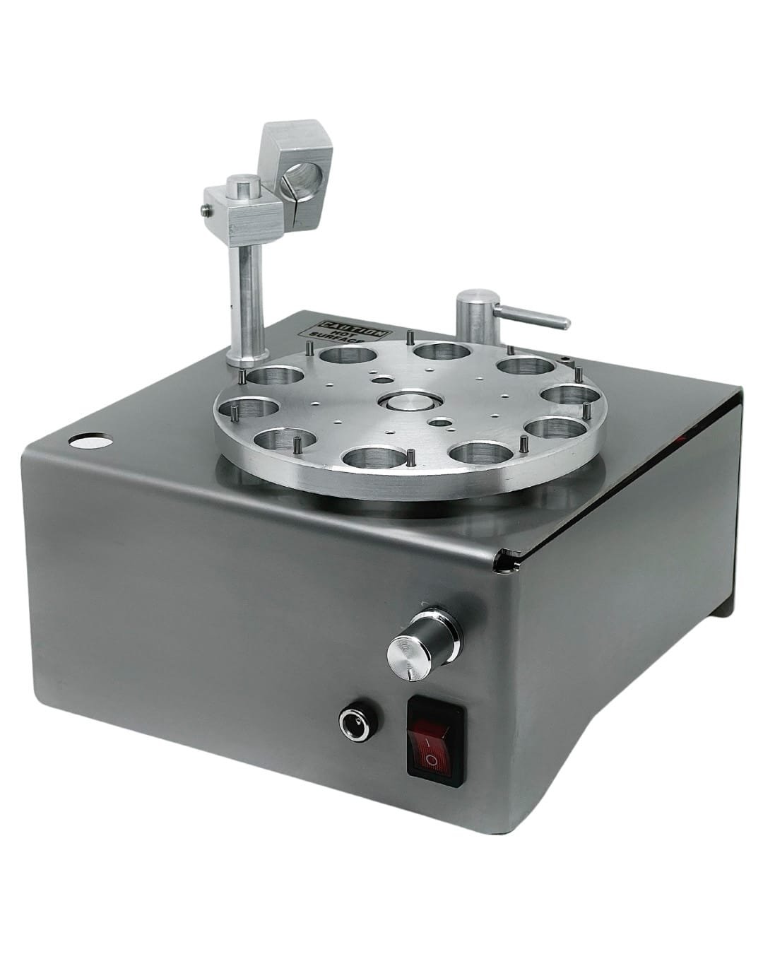

I agree, the AMP is expensive, I went with if because I didn't want to mess with flame. It is a personal choice, and I wouldn't want to pressure you. A lot of reloading is just that, personal choice. We find what works for us and we go with it and we modify it to suit our needs. I put up in my profile that I shoot F Open to give people some idea of what I am doing, there are some that are casual shooters that don't go to some of the lengths we go to to shoot well. I am really still learning, just finished my 3rd year of Competition, I am not in the same League as the You Tube Shooters, I am just happy when I don't finish last. I seek to improve. I have tumbled since the beginning, I don't find it as messy as wet tumbling, I just dump and sift then I am ready for the next step.
I shoot 1000 yd BR and simply wipe the neck/shoulder junction with 0000 steel wool before annealing with my AMP. The one time I did clean with media immediately proceeded my worst showing ever at a LR BR match.

I have been using a Bench Source for 8 years or so. I do it after every firing, take 10 minutes for 100 or so cases. I've seen them used for 400ish.
I also use the BS every firing. Takes about 3-4 seconds per case. Its fast and easy.

I''m looking at Bench-Source too. But its some $600.
