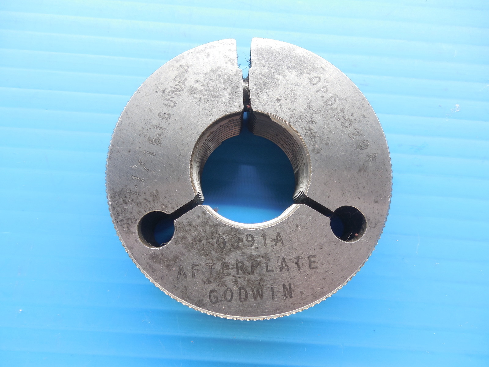

Get a set of ring gages...
This is not a good example mainly because it seems high to me. If you are patient, you can likely find a set(go and no-go) for under $100.
Read up on thread classes and get a pretty good understanding of those, in the meantime.
https://www.ebay.com/itm/1-1-16-16-...=162956365400651e5df9af274aff808f3fda04dc36bc
I am looking at internal threads. I can change the class but max is 1.078 or with in a few thousands.
A Leaphart
Internal/external...you deal with pitch, major, minor, class, etc. Not sure you fully understand what is being explained by others that posted. Changing the major and minor within reason is not going to change class of fit. The number you need to be concerned with is the pitch diameter. The major and minor range is simply clearance when threads are mated together. Set up and chase your internal threads and thread mating tenon to fit. Once it fits, measure over wires and record that number. All other tenons threaded to that number will fit.
