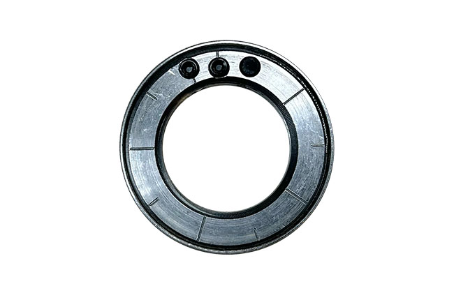

Using one of Whidden’s click adjustable lock nuts works beautifully on Giraud’s shellholders. They’re a little expensive, but they make dialing in the perfect trim length a snap!
