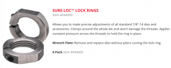

Just a tip, I found using Hornady’s “pinch lock” style lock nuts on your Giraud’s trimmer shellholders will make changing calibers out extremely quick and accurate.
Since I’m not familiar with it, can one or both of you show pics or video of what you’re talking about?
Otherwise known as a 'split bolt' clamp or lock, as opposed to the Redding/RCBS style lock rings that have a set screw impinging directly on the threads (albeit usually with a piece of lead shot in between, to protect the threads from damage).
The older Forster rings used a similar idea, but a) used a wussy Phillips screw head that stripped out if you looked at it sideways and b) didn't have the wrench flats for snugging the die down / breaking it free.
