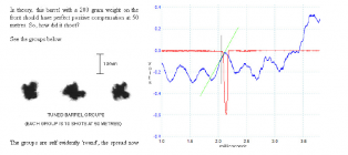

FromKolbe's instrumented barrel;
The green line represents the range of barrel exit time for the various velocities, whereby the faster exits at a lesser icline than the slower., Notice the slope is steeper, not the same at times a bit less than 2.0ms, and could be used for more compensation such as would be required at 100 vs 50yd. Is that different enough to matter, is someone capable of harnessing this? Without more studies such as this we will never know for sure.
