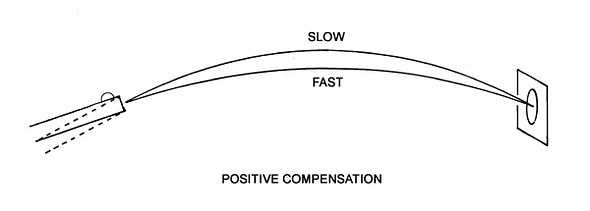

Maybe I misunderstood what Positive Compensation means as it relates to rimfire. but if you truly achieve PC why would distance changes affect it?
my understanding is that PC will flat line slow and fast rounds so they intersect and have same POI meaning if I shot 10 lots of various speeds, they all should have same POI.
therefore, distance should only affect POA to POI meaning adjusting POA is all that would be needed.
PC should not have changed.

I'm wondering how many setup their tuner to shoot good at 50 yards, and it also shoots pretty good at 100 yards....and just accept that as is without trying to tweak the tuner to make it shoot better at 100 yards instead of just pretty good?
If positive compensation works so that faster and slower rounds converge at a single POI at 50 that means their trajectories intersect at that distance. In other words, faster and slower rounds must have different trajectories from muzzle to get to the same POI at 50.
It would seem to follow that rounds with different MV's yet the same POI at 50 must begin to diverge once past 50.
Understanding pc and tuners a bit really helps put a number to that, answering your question, mostly. Because pc can only occur at top of bbl swing but the gun can shoot well at top and bottom, that alone would suggest 50% on the surface. But then you have a fair number of people that tune for different ammo speeds to hit the same poi, which is in fact tuning for pc.

BTW, tuners do NOT create PC. It's there before tuners were ever dreamt of. But they do allow us to manipulate phase time, timing bullet exit and muzzle position for it. Very, very much like handloading in cf.
There's nothing magical or mystical about a rf vs a cf. Both have what's called a cantilevered beam...a bbl, that we manipulate with the tuner to optimize bbl position at bullet exit. Biggest difference is the bullet is in the bbl 3x as long as a rf.

If you go into a ballistics calculator and graph thr path for rounds that have different speeds, but are zeroed for 50 yards, you find that beyond that common point the paths diverge. At 100 yards, for about a 175 fps difference (Lapua OSP vs Biathlon), there is roughly 5" vertical difference in the path. So the angular difference for that velocity difference to coincide at 100 yards is necessarily greater than at 50 yards.
This why PC is not possible partial perhaps but not 100% PC
