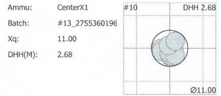

Lapua test results in 2019, 50 & 100m the noted measurement was the first 4 shots which were nearly one hole at 50m so 11mm at 50m and 20.88mm at 100 and it can shoot 50 shots at 100 yds. with a totally different first time shot lot and get those results tells me if tuned at 50 it will shoot at 100 without adjustments as long as the ammo can perform. also, how it was tested in the tunnel is the same way I shoot it off the bench Pappas rest and the same way the 50-shot group was shot.
