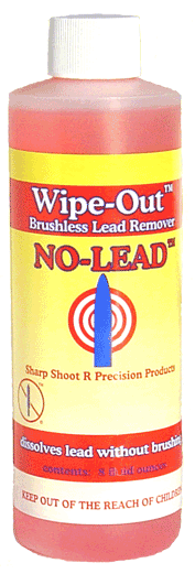

Kroil is a good start. Should that not work, you might look for this stuff:
I have no experience with the Sharpshootr product.
Last resort (IMO) would be the Lewis Lead Remover brass screen thing.

The No-Lead works. Make sure to follow directions. After 20 minutes, it needs deacitivated.
The Wipe-Out, and or Patch-Out, will remove the dissolved lead residue and protect the barrel from corrosion.
I use it.
