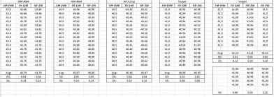

I also found this to be true about trickling onto my GemPro 250. Upon developing a method for getting my GemPro to get the weight I was after (like within +/- .02 gr), I found it was as accurate as my FX 120i (see pic below). . . .however, it takes substantially more time to get my desired weight with the GemPro than with with the FX. Part of the my method had to do with keeping the GemPro from drifting over extended loading periods where I'd return the pan to the scale after emptying it each time then throw a charge in the pan and trickle up lifting the pan up and back down until I got the weight I was after.

In your chart are you comparing what is weighed by your Charge master to the other scales?
Yes.
As you can see, the GemPro 250 measurements were very, very close to what the FX-120i measurements were. And I found it interesting how in the last group on the right, my little Frankford Arsenal DS-750 measurements were right there with the Charge Master's.
