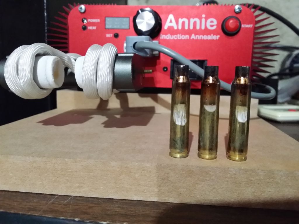

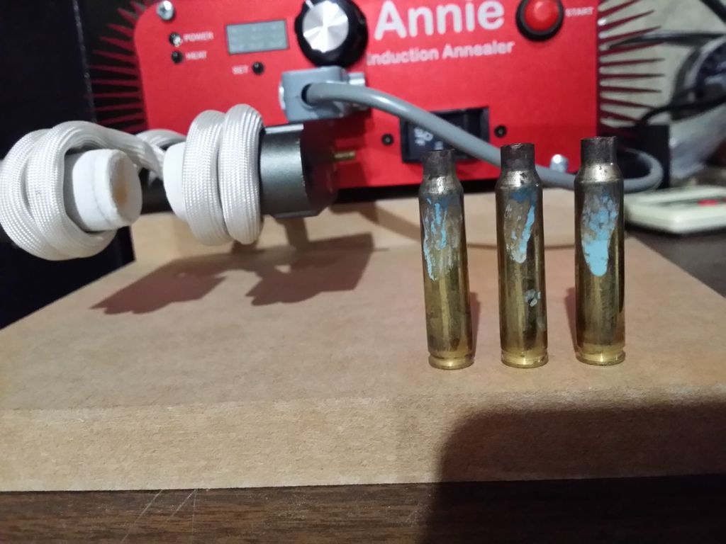

One way of testing to see if the two sources are in fact additive would be to put a spot of Tempilaq that would indicate at a temperature 10 or 20 degrees higher than what the annealer is set for and run 100 or 200 cases through. If it melts then repeat the experiment with Tempilaq of a higher temperature.

Just last week I found I needed 1.8sec to anneal 6BRX cases to 750 deg back to include the neck. This with the Litz wire coil. Yesterday I annealed some 284 WIN cases. The W-W cases required 2.5 sec from the Litz wire coil. When I got to the Lapua cases I got to 3.5 sec without getting the necks hot enough. In fact, it seemed that above 3 seconds, any increase didn't heat farther down the neck. I put on the solid wire coil and found they annealed perfectly at 3.5 sec. I would not be surprised if the 6BRX cases would anneal even better with less energy and 2.5-3.0 seconds!
