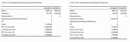

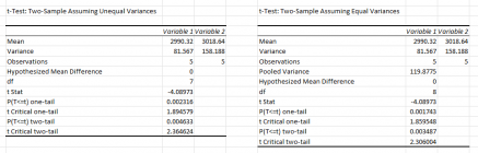

No, it isn't inappropriate and when used in this context it wouldn't change the conclusion.
The common T-test assumes the variances are equal. If they are not, we use the Welch's.
Not sure what you punched into the windows, but it should have looked like this:
If that is what you punch into the web tool you linked, you get the values below.
The delta between the averages is more than 2 sigma apart, so the hunch is the means will be different on visual inspection no matter which method we apply, but since we only have 5 of samples of each...
The variance of the heavy group was nearly double the lighter ones, but let's just play it out and see if it makes any difference with the calculators you showed.
The two samples have averages as follows: 2990.32 AVG SD 9, versus 3018.64 AVG SD 12.6
If we run your T-test we would get:
t = -4.089728
df = 8
p-value (one-tailed) = 0.001743
p-value (two-tailed) = 0.003487
And if we run Welch's we would get
t = -4.089728
df = 7
p-value (one-tailed) = 0.002316
p-value (two-tailed) = 0.004633
Either way, when we only have 5 samples the conclusions are weak, but they still point to a difference between the two primer weight averages. All of these tests do better with more samples.
In both of these tools, the p-value is less than the Alpha of 0.05, so the two means are not the same and there is a likelihood the light primers are in fact slower than the heavy primers.
So, something went wrong with your input window, but it should be obvious on visual inspection that the two groups are not the same even without the details when you see the averages are spaced by more than two sigma. Your DF should have been N1+N2-2=8 so I think your input window may have an error?

Entering the heavy first and rounding I get
t = 4.147956
df = 8
p-value (one-tailed) = 0.001609
p-value (two-tailed) = 0.003218

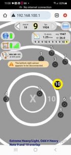

First ten shots, Extreme Heavy/Light.
Odd # shots were Heavy.
Don't know if I can trust the SM data for this group.
Got Sensor message during the group.
Sort of looks like group in post #5.
t = -4.089728
df = 8
t = -4.089728
df = 7
Thanks, I don't know what I did wrong, but wrong it was. I recalculated and I was nowhere near accurate in the first iteration.
I appreciate the correction and the time you took to do it.
Odd # shots in post #5 were LIGHT and LOW, First shot LIGHT.
Odd # shots in post #51 were Heavy and HIGH, First shot Heavy.
Suspect errors with post 51 ShotMarker data, position and velocity.

Separated the medium 10 plus 4 sighters from the Heavy/Light test.
1 -- 3.765, 3.400, 0.365, 3036.8
30 - 3.625, 3.375, 0.250, 2989.2
2 -- 3.760, 3.390, 0.370, 3042.7
29 - 3.625, 3.360, 0.265, 2989.0
3 -- 3.765, 3.385, 0.380, 3054.4
28 - 3.620, 3.360, 0.260, 2987.4
4 -- 3.775, 3.405, 0.370, 3058.4
27 - 3.615, 3.370, 0.245, 2993.1
5 -- 3.755, 3.395, 0.360, 3050.2
26 - 3.610, 3.360, 0.250, 2977.4
6 -- 3.755, 3.395, 0.360, 3046.2
25 - 3.630, 3.380, 0.250, 2996.3
7 -- 3.750, 3.395, 0.355, 3037.8
24 - 3.630, 3.370, 0.260, 2982.8
8 -- 3.750, 3.385, 0.365, 3047.0
23 - 3.630, 3.370, 0.260, 2992.5
9 -- 3.750, 3.390, 0.360, 3055.4
22 - 3.635, 3.370, 0.265, 2987.9
10 -- 3.750, 3.390, 0.360, 3029.2
21 - 3.635, 3.365, 0.270, 3021.1
11 -- 3.740, 3.380, 0.360, 3055.1
20 - 3.635, 3.360, 0.275, 3010.1
12 -- 3.730, 3.385, 0.345, 3053.5
19 - 3.630, 3.360, 0.270, 3010.3
13 -- 3.730, 3.380, 0.350, 3063.0
18 - 3.635, 3.360, 0.275, 3013.2
14 -- 3.730, 3.380, 0.350, 3032.3
17 - 3.635, 3.370, 0.265, 3003.1
15 -- 3.730, 3.385, 0.345, 3044.6
16 - 3.640, 3.375, 0.265 2999.9
Range of primers: 0.165 grains
Range as fired: 0.045 grains
Range of weight loss: 0.135 grains
Extreme Spread of Garmin Xero muzzle velocities 85.6 fps.
Medium 10 +4
Initial weight 3.66 +/- 0.02 grains.
As fired weight 3.390 - 3.365grains.
Weight loss 0.270 - 0.295 grains.
Weight loss with initial sort tolerance (3.66 bin) of +/- 0.02grains, 0.250 - 0.315grains.
After the wife shot her first group and I shot mine we got this "Sensor Disconnected message on the shotmarker.
It can make "some" difference but not enough to worry about unless you are in a match.
With all the sensors working well, the system will use them all and the results are "smoothed" by averaging. With only three, there may be a little accuracy error but not enough to change your conclusions.
We have had guests clip a cable with a wild shot and we just keep running. In an important match, we stop and go down range to fix it, but in a club match we won't hold a line for it in the middle of a relay.
