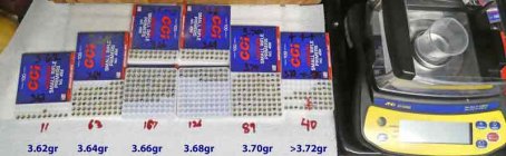

Sorted the remainder of the previous brick. There will be some overlap in the groups.
I need a few more of the 3.64gr group to make a batch for Saturday's match.
Might fudge some lighter ones from the 3.66 group.
Have enough of the 3.66, 3.68, and 3.70gr
Range of what I got was 3.615gr to 3.755gr.Then next week Highs and Lows.

I sorted and loaded some Light-Heavy CCI450 for another primer weight test for me to shoot in the AR.
Recorded individual weights and will shoot 6 groups of 5. I should be able to correlate weight to Garmin to ShotMarker.
