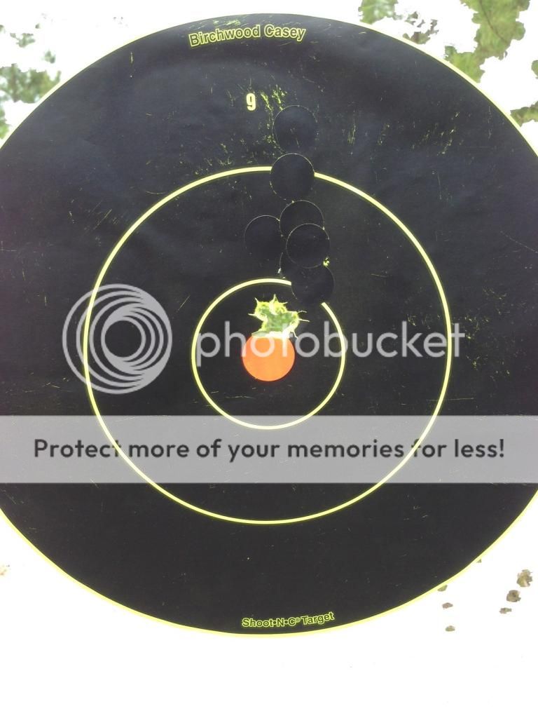

The rig was somewhat front-heavy with the longer/heavier barrel and a stock that weighs next to nothing. Adding the scope helped to balance it some. I had yet to load any rounds for this rifle because I was wanting to fire-form a few cases to see if the dimension match the reamer print. So I used a box of Federal 168g GMM for the break-in and initial groups. I only had to fire 3 shots before the copper fouling tapered off. After the break-in and some more shots to walk-it-into the center, I went ahead and fired a 5 shot group at 100 yards. It was 85 degrees, humid as F*CK (meteorology term), and the barrel was still warm from the previous shots.
This goup measured 0.406. This rifle is a pleasure to shoot and I'm impressed with how it shoots factory ammo. I'm in the process of working up some handloads for it and will report back when I get some results.
