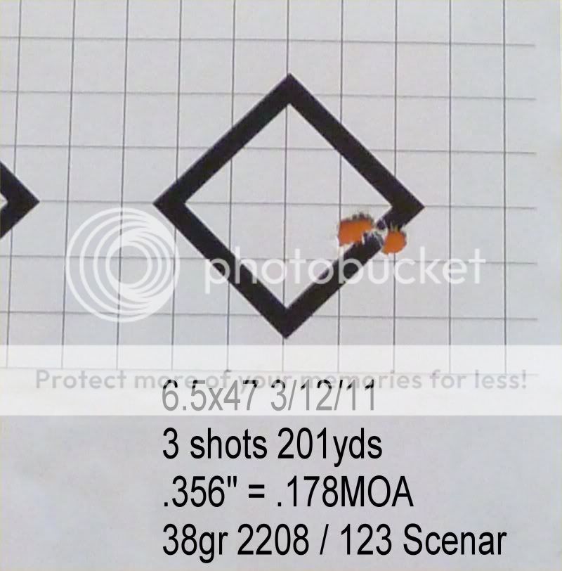

Here's the one and only group I shot last Saturday to check the scope zero prior to a varmint shoot.
Variable 4-8mph wind at 200yds- not corrected for
BTW, 2208 = Varget. ADI make it for Hodgdon.

Well, it was a funny thing KT.
I used the brass straight out of the box, did a bit of reading, measured the throat position and put together three loads: 37.5, 38 and 38.5grs.
Fired two three-shot groups of each. All were nice but the 38 stood out, one under 3/8" and the other a 30cal hole ::)
No significant pressure signs at 38.5 but the group wasn't quite as nice so I stuck with 38 and it's a tackdriver.
I have a pic somewhere of a 4-shot group of 0.9" at 392yds.
