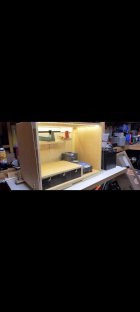

I don't know if this is what you are looking for but I use this with a front window when I reload at the range. Even during 10 MPH wind both electronic & beam scale stay solid. So it may help you as well.
