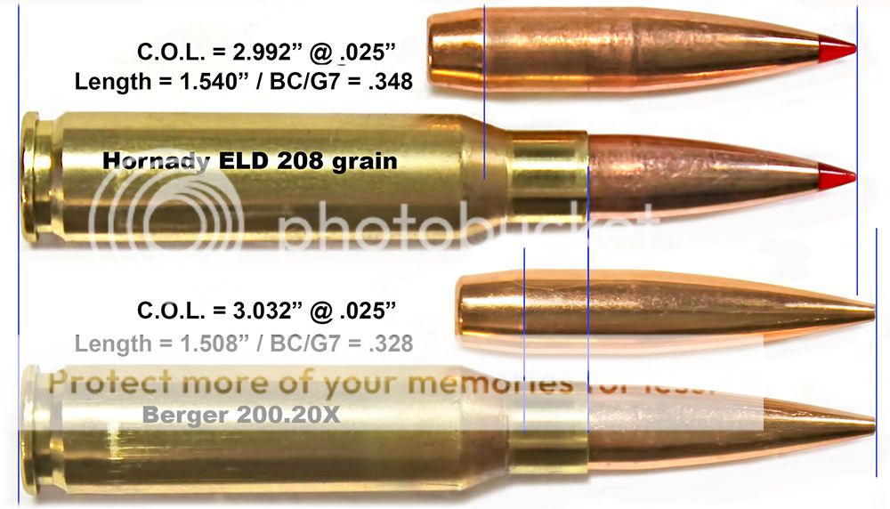

I just got a box. Haven't shot any yet but loaded enough for a test just today. I did this drawing to show someone. My current long range load is the Hornady ELD. It is a slightly compressed load with 41.5 grains of Varget (2,430 fps) as it is configured here. The 200.20x will allow more case capacity and hopefully more velocity. These were seated to have a .025" jump in my rifle which seems to always work well. Seated this far out the Berger's still have about 80% contact in the neck. Out of a box of 100 the weights ranged from 200.04g to 200.32g. I measured a few and they had an average runout on the bearing surface of .0003" which is about normal for most match bullets.

2013 FTR Reamer, not sure of the BF2CM measurement, but 2.025 looks common of the few prints I pulled up. The numbers given above in the picture are on a brand new chamber for reference.
Not much neck contact with the 200.20x or the 185 Jugg. How did these compare for accuracy?
It may not appear that way in the image, but the boattail/bearing surface junctions for both bullets is over halfway down into the neck; or less than halfway out of the neck from the neck/shoulder junction. That is plenty of shank in the neck.
