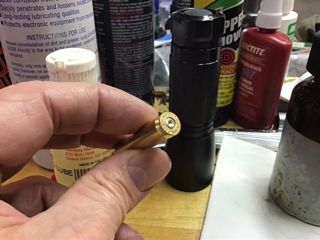

And it w/b nice to see the primer indentions on the 450's, in good focus if possible.
