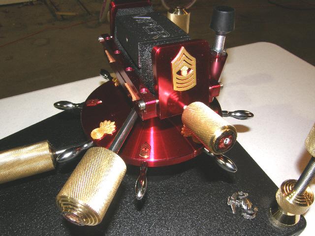

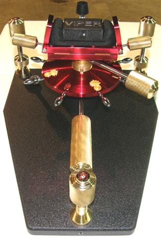

Bob built me a rest a few months ago, and the way Bob and I met is another whole and long story, I think the world of the man and his work. when ever anyone feels that way about you you are doing something right. here's a few shots of my "Viper Rest"
Roland

Bling City! My shooting buddies would never stop giving me grief if I showed up with that.
Go with Bob Pastor, he's as good as they come and will customize to your needs.
Give him a call, and oh ya, ask him about his man eating oven...LOL
Tell him Eddie Fosnaugh sent you and maybe he'll give you a discount.....or he may charge extra! ???
Man those Vipers look nice. I did however get a SEB from Ernie B. I really wanted a joystick control and Ernie was great to deal with. Thanks for all the input it was a tough decision but I hope it was the right one for me.

Kilshot, Bob actually did all of the "Bling" as you put it on his own, I thought I was just getting a rest. Now with that said I don't really give a flying ----- how much grief I get I've got thick skin, and not only that but the coolest rest I ever did see. 8)
Roland
