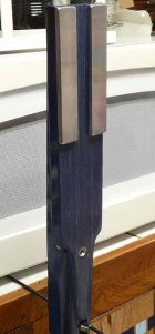

EGW delrin off ebay $42 shown on my CZ with At One--works like a dream ! Showed up at factory class match and was told not legal--had to remove it--a shame rifle shot best ever with it--I am up against $3K rest even in factory class so I could not understand what the fuss was but will come up with a Plan B Nice piece cheap--works!

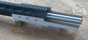

Give me a minute. I'll do a quick proto. In the mean time.
i modded a a piece of heavy channel to bolt to my personal
3" design to go 4" or as wide as I want then back to 3" if
rules tell me I have to. I'm not constrained by a box......
This is done on a chassis rifle. I'll whip something up for an
AR shortly.....
