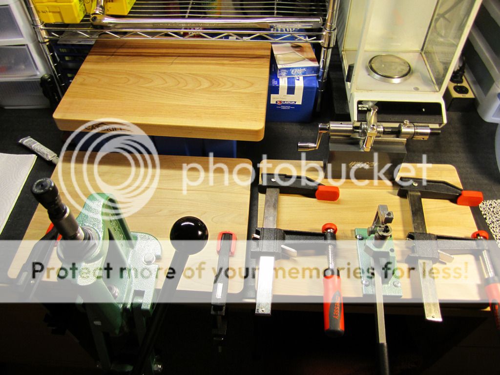

In order to make a "modular" system because of limited workbench space, I mounted several pieces of my reloading equipment (press, various trimmers, primer tool, etc) to hardwood cutting boards that are clamped to the reloading bench during use. These can be switched out easily depending on which tool I may need to use at the moment and only requires a short section of benchtop/desktop:
I am using Catskill 1 1/4" thick cutting boards. As cutting boards go, they are not too expensive. There are likely other less expensive hardwood options out there. I chose the hardwood cutting boards rather than pine, due to concerns about stripping the lag screw holes. However, sections of 2" x 12" would probably work fine if you used bolts and countersunk the heads on the bottom. The press is in use on the board at left. The board on the right has a case trimmer on one side and a priming tool on the other, and the clamps are shown laying on top. An extra cutting board not currently in use is shown in the back.
