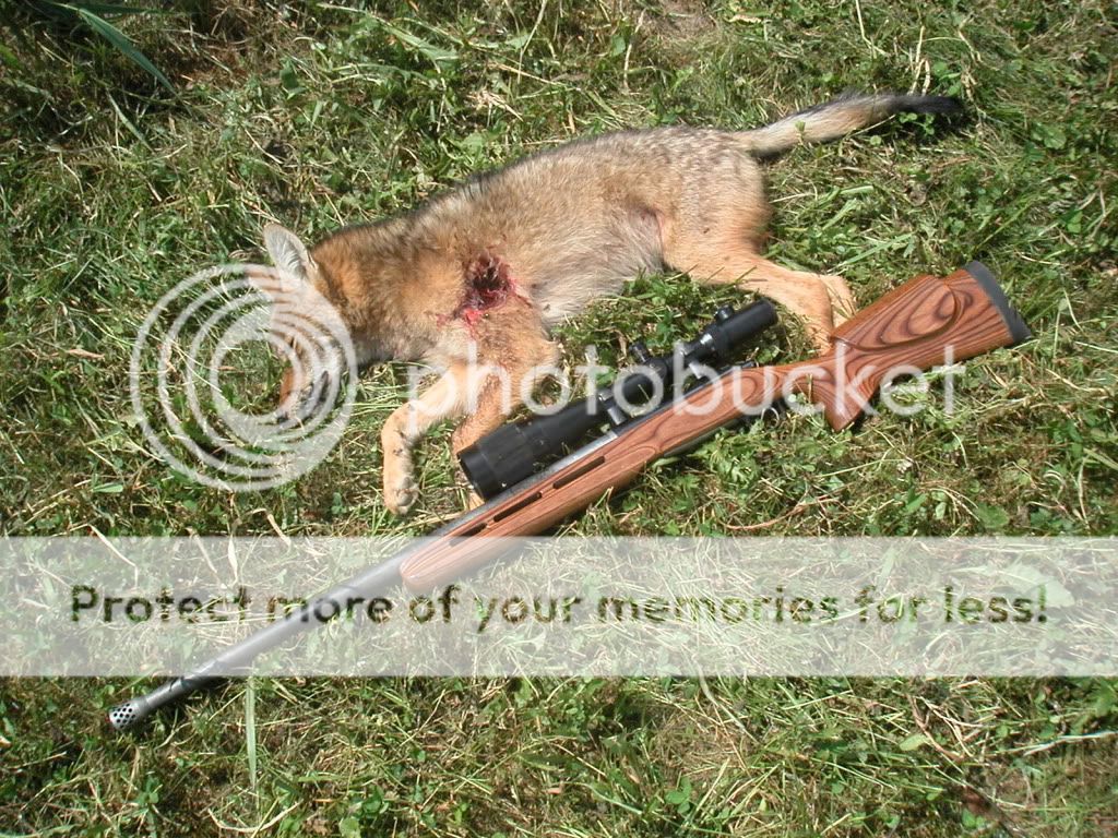

Here's a coyote taken at about 300 yards with a 80 grain Fowler flat base bullet out of my 28 inch 6mm Ackley.... Pretty normal exit hole with this bullet....

Thx guys! For some reason I couldn't access the forum for a couple of days! Preacher, that is one fine looking rifle you have there and it appears that the Fowler 80 grainers anchor critters pretty well! Thanks again!
