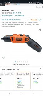

I have used a few regular small rechargeable drills and electric straight screwdrivers over the years and just got this $20 screwdriver beauty. Low rpm 200-240 and full torque when want to lock chuck on holder, compact and way more ergonomic than straight screw driver. Grip is same length as a Glock 19. Wont turn when you twist to lock case in chuck. Just a FYI

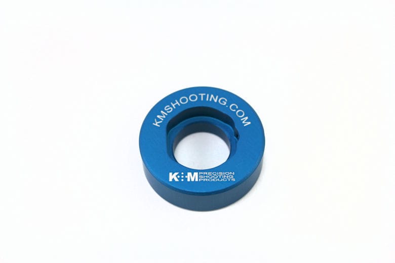

Which holder is that?
Yes it is the K&M and great idea. The outside rim needs to be knurled for waxy hands!
How long does the battery last? Looks like a great little driver for the odd ball annealing that I would use it for.
I tested it on 20 cases. Guarantee you it will last longer than you want to work it! It is rechargeable but can also take a regular battery.
Not sure if 250 rpms is in my range though. I use a cordless drill now with low/ high range. I use low range and just barely spin the drill chuck. i'm guessing it's more in the 120-150 rpm range. Is the trigger on this model progressive or just a simple on/off switch?
On/Off. Manual says 240 rpm no load. By sound it definitely slows down a tad once there is a little pressure. Must have a sensor. All I do is skim but the base of neck is always thicker so it gets a full shave and I can hear it slow. It dosent seem to be too fast at all. At least it is even rpms.
On the B&D do you have to twist lock the hex shank into place or does it hold just by being popped in?
Just stick it in. You've made me remember It does pull out when pulling on the case. I taped it to stop that. When i had hundreds to do i used my regular drill. It took some of the load off my hands.
