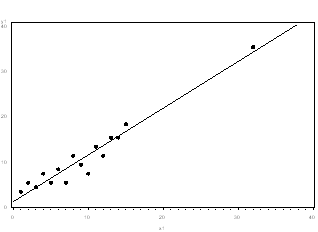

  2. If the outlier does not change the results but does affect assumptions, you may drop the outlier. But note that in a footnote of your paper.
    Neither the presence nor absence of the outlier in the graph below would change the regression line:
    graph-1

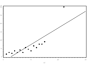

  3. More commonly, the outlier affects both results and assumptions. In this situation, it is not legitimate to simply drop the outlier. You may run the analysis both with and without it, but you should state in at least a footnote the dropping of any such data points and how the results changed.
    graph-2

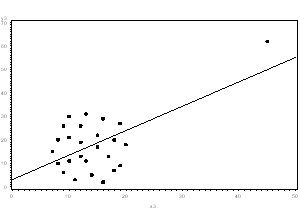

  4. If the outlier creates a strong association, you should drop the outlier and should not report any association from your analysis.
    In the following graph, the relationship between X and Y is clearly created by the outlier. Without it, there is no relationship between X and Y, so the regression coefficient does not truly describe the effect of X on Y.
    graph-3
    graph-1
    graph-2
    graph-3
