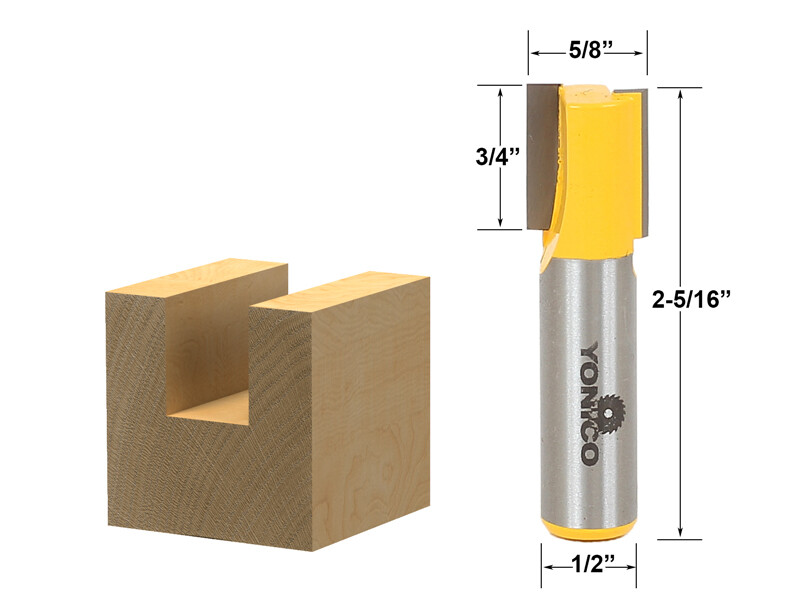

Carbide router bits run at fast speed in a mill are a bit more user friendly in both wood and composite. Cut very crisp edges and stay sharp much longer than running a milling cutter designed for metals. Some masking tape on the stock at the cut locations, and hold stock very rigid. Cheeep on fleabay.
