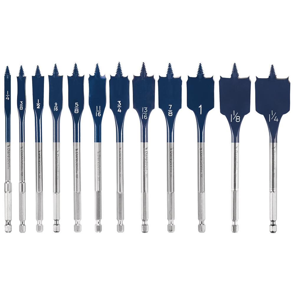

Spade bit gets my vote. Inexpensive, doesn't try to feed itself, and can easily be customized to cut a hole that is smaller by a smidge. jd
