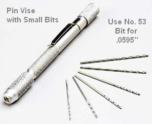

I just talked to Bob Blaine at Sinclair. He said another thing that can work to remove the little slivers of excess brass we've seen with recent lots of Lapua brass. Get a pin vise,$5 at hobby shops) and insert a #53 bit,.0595" diam.). Bits cost about $1.00 or you can buy them in sets. A 19/32,.0538") bit will work too.
Just shove this straight into the flash hole to snap off the little flat "quarter-moon" that you'll find in some of the cases. Then spin the pin vise a bit to clean up the edge.
