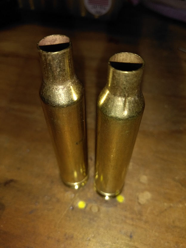

I bought 300WM brass recently, same issue with more than half and also had pleats in the necks and shoulders. One piece is pleated so badly the neck is fully folded in and not usable.

5 ish years ago I had a batch of 300WM Winchester brass that looked like these, I fired them all once before case prep, all but a few with the folds on the shoulders turned out fine... the dented necks look ugly but once put though a full length die and fired they straighten out fairly easily..
