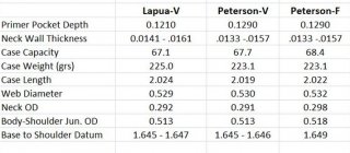

As RegionRat mentioned, if this is new brass to you, it'd be a good idea to take a bunch of measurements to compare them to what you're familiar with. I did this with some Peterson 6.5 PRC brass I acquired last year comparing not only virgin brass but also what they were after being fired):
