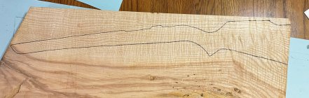

I’m looking at starting a stock build for an old Czech Mauser I got from a guy I work with a while back. The plan is to inlet the stock to be able to accommodate a mediumish varmint profile barrel eventually, but for now it has a take off military profile 8mm barrel.

I saw this piece of flamed ash on my luthier tone wood suppliers website and thought for the price it would make a killer stock, or some pretty kindling if I screw it up lol.

Nice piece of ash! That is one of my favorite woods to play with. The smell is addictive.
It is usually pretty heavy, which is not necessarily a bad thing.
One thing have never tried is checkering it.
I’ve built a couple guitars from swamp ash, and yeah I enjoy working with it as well…
I’d thought about checkering, and I’m not sure how the open grain will work with traditional checkering. My initial thought is to do a texturing type of checkering to avoid issues with the pores not looking right. But I’ll probably try on some scrap pieces and see if it looks alright once I get there

Have you considered putting a dowel through the wrist? The grain orientation through the pistol grip may prove to be a little fragile.
I thought about it, but it isn’t as flat sawn as it looks in the pics and is really closer to rift sawn. It may still need reinforcing though

That sounds way more dismissive than I meant for it to. I’ll try to get some more pics of the wood grain tomorrow when I wake up and see what you guys think

Don't sweat it, it's just really unpleasant after all the work and then the stock gets broken.
