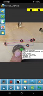

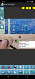

Mag Length ( 2.250 OAL) 77gr SMK in LC 21 Brass, CCI 450. 24.0 Grains of R15.5 produced a Velocity of 2848fps in a Shilen 26" barrel. SD of 13.7fps
600yard group ( 5 shots)
.51 MOA
.21 MOA High
.47 MOA Wide
Zero signs of pressure

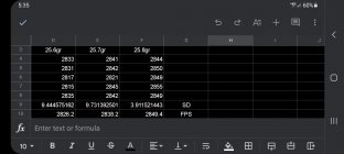

Loaded 5 rounds each at 25.6, 25.7, 25.8 and shot them at 300 yards slung up with my service rifle. Primers looked good, but the brass had some nice ejector marks. The group opened up at 25.8 and wasn't nearly as nice, but 25.6 and 25.7 showed lots of promise. Unfortunate, because the SD at 25.8 was really low.

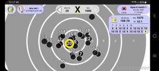

Shot 25.6 grains with my service rifle for a string at a 3x600 today. Very happy with the results
Your not allowed to shoot that kind of elevation at 600 yards with that much powder because its so compressed. Stop it. LOL.
It’s the 4.5x power scope with a 20” barrel held with a sling that makes it possible. Anybody could do it…
