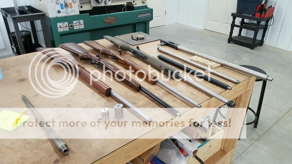

So I've shot a lot of different calibers over the past few years of shooting rifles for more than just hunting. Some big some small. Some accurate and some not so much. I bought a 6brx barrel off a member here last year and I enjoyed it's ease in finding a load. People around me were telling me that the straight br was even easier so I had to have one to see for myself since the BRX was so easy. I had a 1-8 brux barrel laying around for a target type gun and saw Lee Gardner had a little lull while waiting on parts for other guns. I called Lee up and he said he had a great reamer for the bullets I was looking to shoot. I dropped the parts off by him, along with a bunch of other stuff and 2 weeks later I had it all back. Took it out yesterday with some loads of varget and 105vld hunting bullets. To say this thing is easy to tune is a vast understatement! I loaded up 5 from 29.1-29.5 to sight in and 5 of each 29.6,29.8,30.0. All loaded .010" jammed. They all shot great and I am going to load a bit higher as I hit no pressure signs. Thanks Lee, this br is stupid easy!
