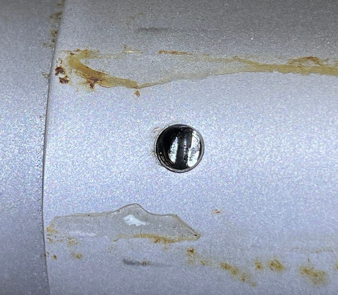

Firing pin hole drilled off-center - how to fix?
If the firing pin hole is off-center, does that mean the other portions of the hole through the bolt are also off-center?
Maybe someone can steer me towards an explanation, or video, or cut-away image of bushing a firing pin hole so I have a better understanding of what that means?
There in could be another problem. If the bolt’s ID is not true with the OD, then bushing the hole to get it in the center of the bolt body OD might result in te firing pin binding in the ID. This could result in more ignition problems than the hole not being in center.
For what it is worth, I don’t really think you have that big of a problem. I have seen post 64 Winchester push feed actions with the firing pin strike so far off center that it was amazing it even fired.
My advice is to shoot the rifle, take a good look at the primer strike, and decide if “fixing” it would be even worth the effort.
I rebarreled a custom action for a customer. A really good 600 yard sling shooter. It was a Remington clone and I cut the bolt nose cbore as I normally do and the bolt wouldnt close. I ended up cutting the cbore 0.040 oversize to get the bolt to close. The rifle still shoots high x cleans at 600. For a controlled feed gun I would lose absolutly no sleep over that firing pin issue.

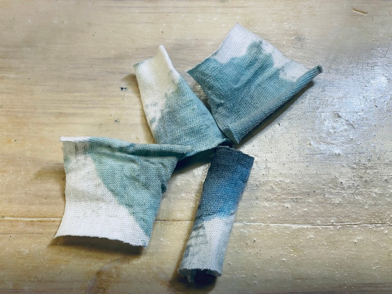

Thanks for everyones' suggestions. I am in the process of cleaning the barrel, and I am pulling out a fair amount of copper.

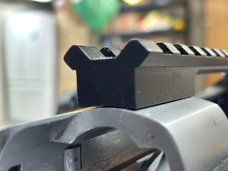

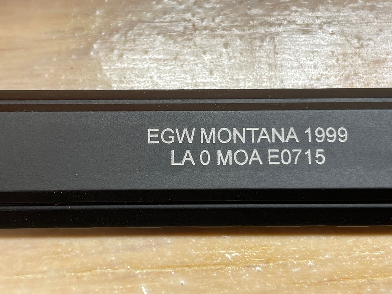

And, the scope was mounted on a rail, which, despite appearing to be correct for this gun, did not make good contact with the rear bridge of the action. The curvature of the rail did not match that of the bridge, and, either the action or the rail is not straight.
And, when I removed the rail, I found that the front screw was bottoming out on the barrel threads. (The rail was floppy-loose when the only screw holding it on was the tightened front screw.)
