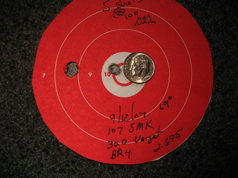

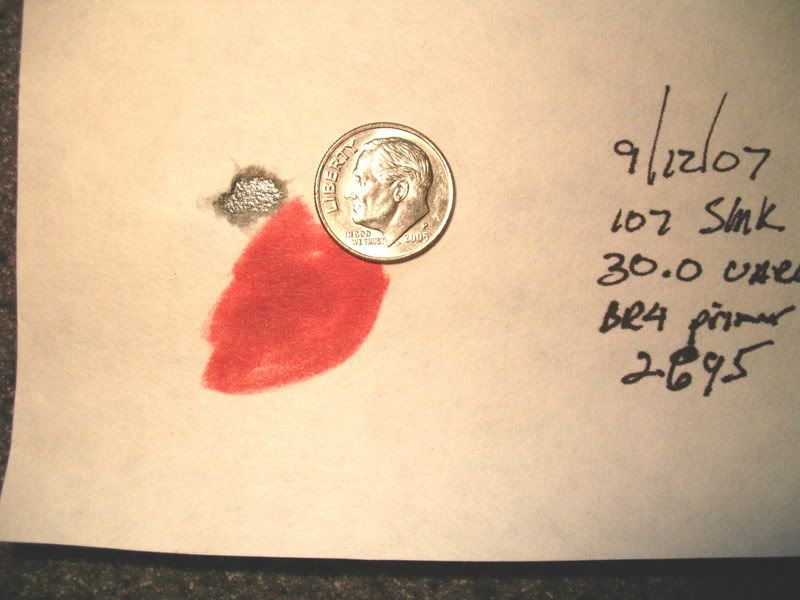

I stopped at the range on my way home from work the other day to get a 100 yard zero on the scope I just mounted on my new rifle. There were targets up from a previous user, but with a 36X scope I could see there no hits that would be in my way. I fired two shots, then made the adjustment. I fired 5 shots for a group and it looked great through the scope. I fired 5 more shots on a different target just to see if the first group was a fluke. I couldn't believe what I was seeing, so I walked down range to pull the targets.
First group: .342-.243=.099
Second group: .265-.243=.022
I know this was only one time, but these are the best 2 groups I've ever shot!
I hope I can do this again, but I have the groups hanging in my office to remember.

I've been shooting custom tactical rifles for a lot of years. My best group had been a .168" shot with a 300 mag that had every trick in the world done to the brass. These groups were fired with only case mouth chamfering done to the new Lapua brass.
The best thing about the tiny .022 group was I fired it on a target that had been shot by someone previously. There was only one hit on each of the 5 bulls on the target. The bull I shot on had one hit 2" out at 9 oclock. My 5 shot group in the X -ring is noticeably smaller than the one 30 caliber hole!
The other shooter that was at the range looked at these groups and asked me if I was going to shoot benchrest. He offered to buy me my choice of any barrel I wanted, and have it fit to my rifle in exchange for my barrel. I told him I would let him know. Sure.

I finally got to take a couple pictures of the two groups from my new 6BR. The first 2 groups with the rifle, and I doubt I will ever do this again.
I will try to attach them.
