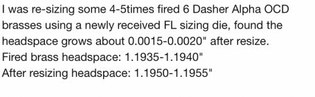

I was re-sizing some 4-5times fired 6 Dasher Alpha OCD brasses using a newly received FL sizing die, found the headspace grows about 0.0015-0.0020" after resize.
Fired brass headspace: 1.1935-1.1940"
After resizing headspace: 1.1950-1.1955"
