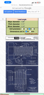

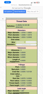

Kelbly actions are held to very close tolerances. Most who know their actions would have no hesitation to chamber a barrel and send it through the mail to the customer. Threads, shoulder, chamber, barrel markings will be proper. Most all who do barrel work have measurements and notes on actions they have worked on, where they don't need that action again.
Threads have a lot of toleranced dimensions and one can probably assume that for most manufacturers, if a thread plug go goes in and a plug no-go doesn’t then it is in fact “in spec”.
3B internal is the tightest real standard and if you want to go more you are really just costing yourself $ in time, tooling and probably scrap.
