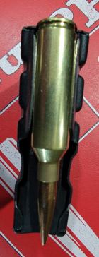

Hey Guys,
i bought a prefit 6.5PRC for the Impact 737 SA, and grabbed the mag that I had bought a few years before for a 25 SAUM. I figured it should work and it feeds flawlessly. Never had one malfunction with either a SAUM or PRC. I am not sure what mag this is, I think I recall they called it an Alpha mag. The SAUM and PRC are both on Impact Actions, no issues whatsoever. I am not sure if this is a single stack or not, but you guys would know. I hope this helps the Op or anyone else.
