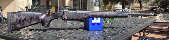

Your rifle is stunning. Makes my low wall look like a jack handle. Has it always had the double set trigger setup? What caliber?
Thanks! It is an original Winder action with a set of Ben Rice aftermarket triggers from what I understand is the 1970’s or 80’s. The rifle is a .22lr!
