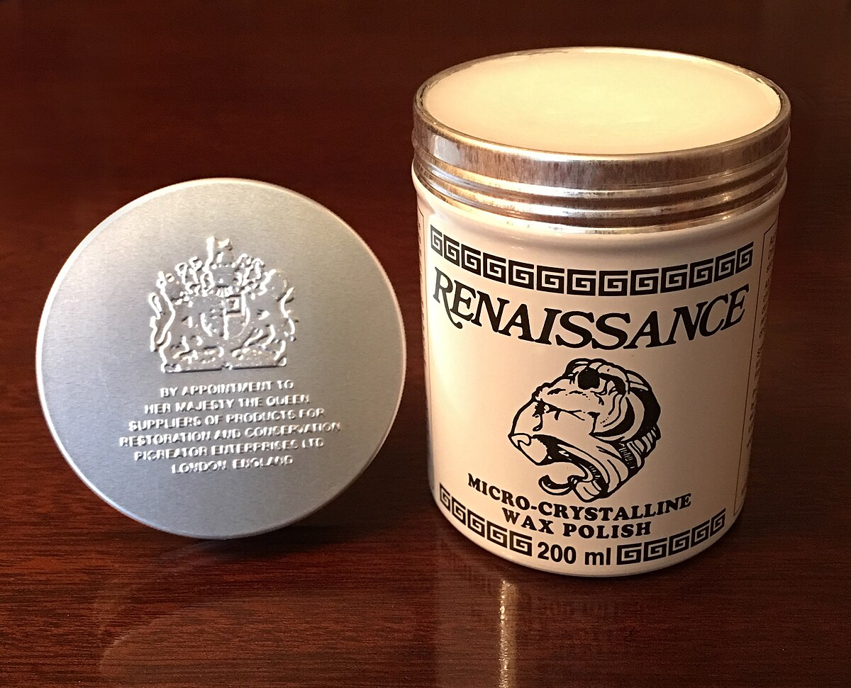

Wax or finish? B/C Tru Oil Stock finish will get the job done. Apply it with your finger tips and rub it in. Wipe off the excess. ;)
